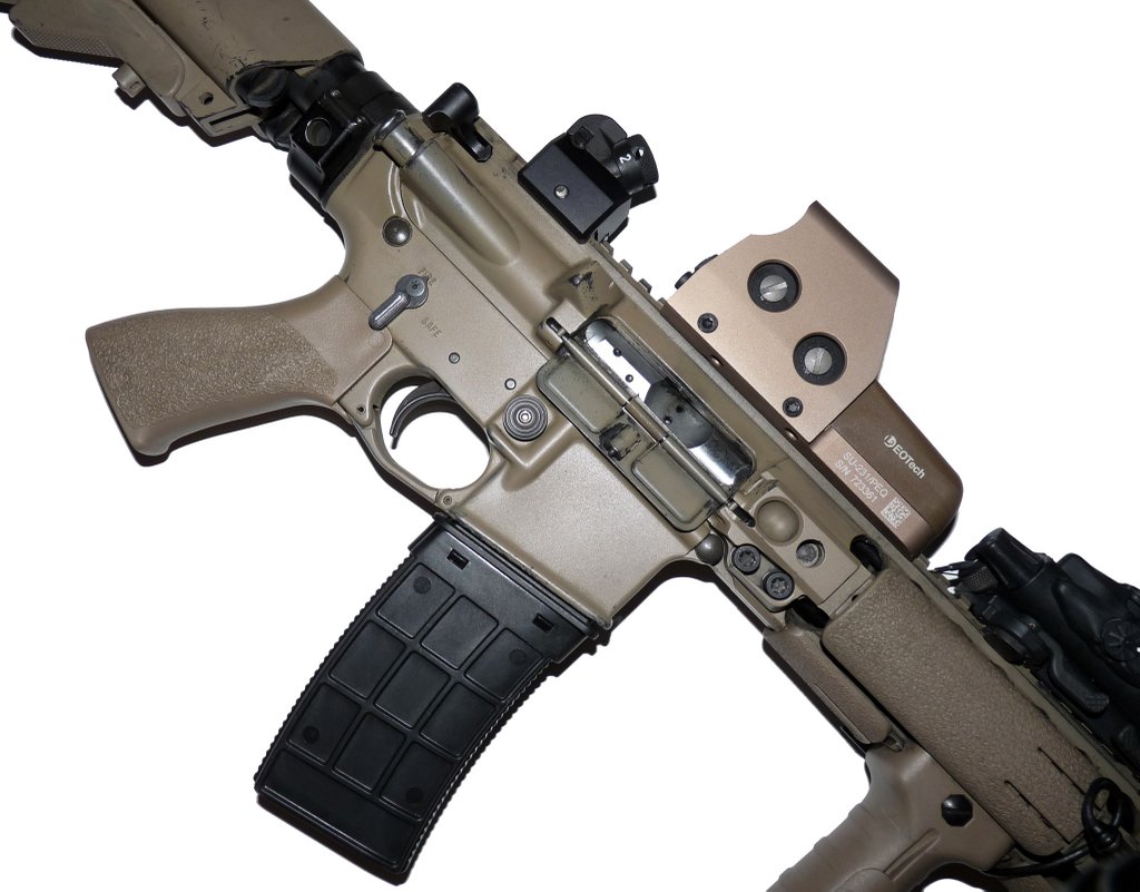

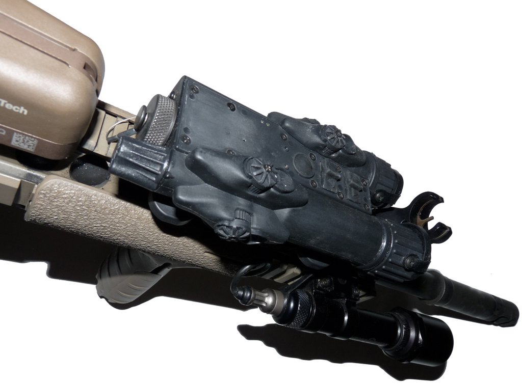

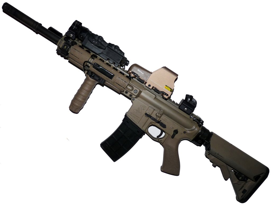

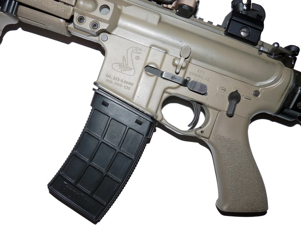

    This is the latest updates to my trusty ole LMT MRP based on my registered pre California AWB Bushmaster lower.
    LMT MRP CQB with 14.5inch barrel. The barrel has a pinned on Surefire MB556AR muzzle brake that also act as a sacrificial baffle for the Surefire suppressor that belongs to a C3 friend of mine. the pinned muzzle brake makes the barrel legal 16.5 inch length.
    EOTech 553

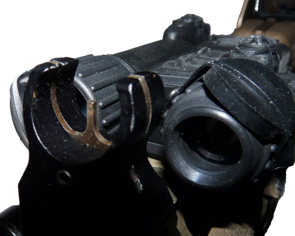

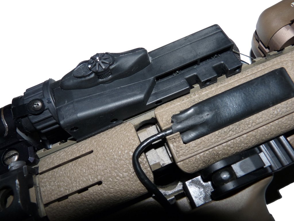

    Nightvision System Atilla IR laser
    TangDown QD vertical grip and pistol grip
    TangoDown SCAR rail panels
    TangoDown rear Sling swivel mount
    KAC front Sling swivel mount
    Centurion Arms 416 Style front and rear sight
    Surefire Scout light with 6P conversion bezel with aftermarket 250lumens LED lamp
    PRI Gas Buster Charging handle
    Young Manufacture Bolt Carrier group
    LMT Ambi safety
    Accuracy Speak Single stage match trigger
    KAC ambi magazine release
    LMT SOPMOD stock
    Magpul trigger guard
    IR laser under my PVS14
    IR Laser with illuminator------bad camera work, the point and shoot just don't do the PVS14/IR laser combo justice

    SMGLee, You could really show how great of a guy you are, by sending your poor Oregonian friend a few of those ARs, set up like that.
    Very nice rifle, thanks for the photos.

    That's a good looking rifle Chen. How does she shoot?

    hey, very nice rifle SMG.
    Are those scar rail panels available to the general public?
    How is that single stage trigger? Would you prefer that over a good 2 stage, like a geissele ssa?

    so far this gun shooting M855 with my EOTech 553 and a 3x magnifier can hang in there at 100trds with a 2-3MOA group.

    The Tangodown SCAR panels are now available in both FDE, Foilage and black. like BJ mentioned, you can get them from Bravocompany
    I like the single stage trigger a little better, it is personal perference, but for me it is more reliable and it makes for follow up shot slightly quicker.
    I would recommend waiting a bit for the Colt competition trigger to be released soon. before, the competition trigger was only available if you buy a colt match rifle, and it is only available in large hole format. it is now available in a small pin or mil-spec pin size and will b e available on the market soon. it is cheaper, reliable, and have a very nice and crisp feel to it.. you don't want too light of a trigger for a combat rifle. my accuracy speak breaks at a clean 5lbs.
