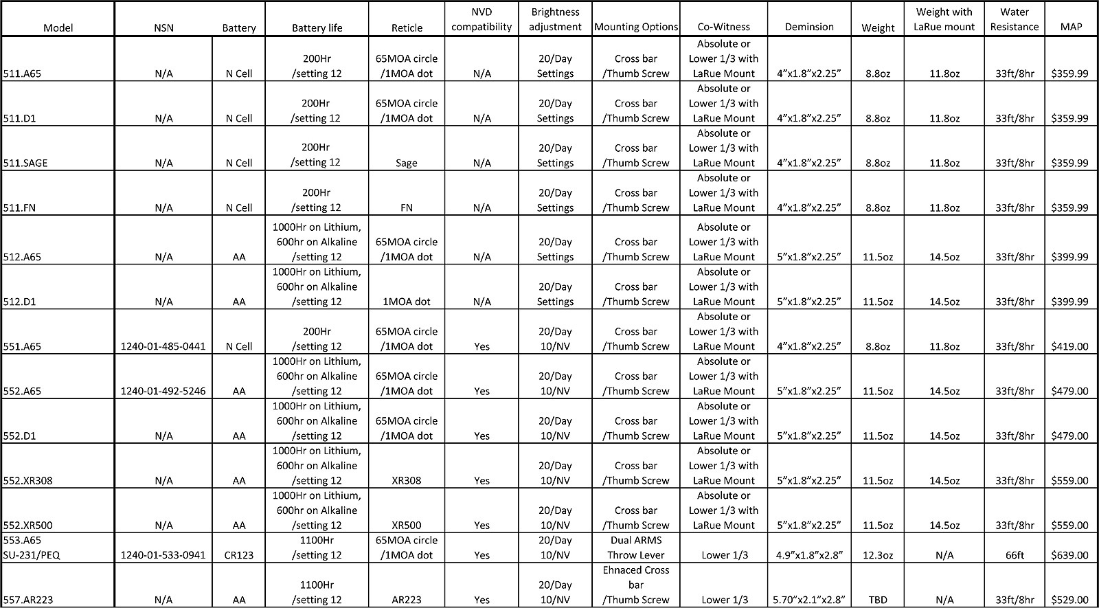

    A lot questions has always foucsed on EOTech....
    Made a little EOTech chart inspired by a member from another forum.
    this is the LINK to the original size file for those that need glasses........

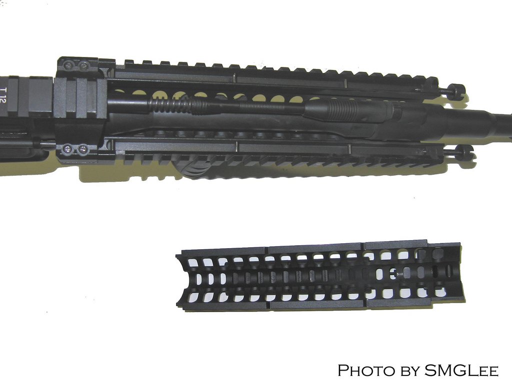

    PWS-Primary Weapons Systems

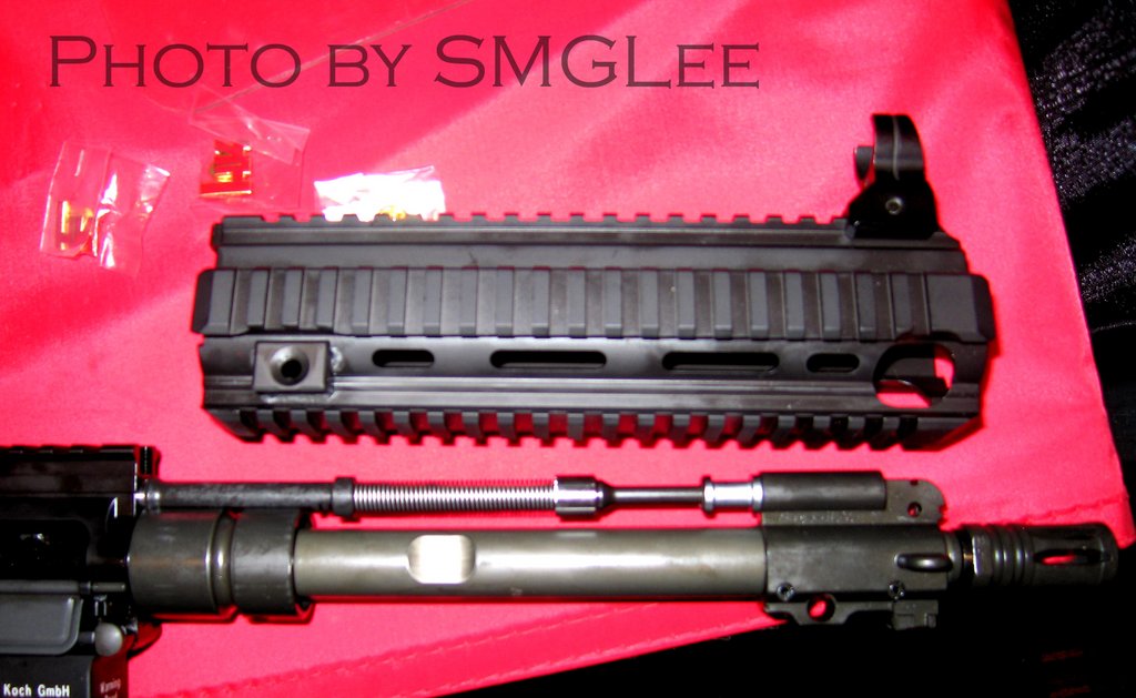

    this sytem interest me in several reasons. one, it is low profile enough to be compatible with some rail system right off the bat. the excellent Daniel Defense system is one of them. no modification are required to the rail.
    the system are front loading so you can retrive all piston components for cleaning without removing the rail.
    the gas adjustment in the front offer a few positions that can be used in various operaion requirement. you can shut off the gas and turn this into a bolt gun for covert sniping.
    the system is high quality with a reasonable price, with the DD rail, this conversion is approximate 300.00 or more less then the competition.
    the stainless gas knob will be finished in production version to be less refective.
    the bleed off or the gas vents are behind the gas regulator. as you can see from some of the vent holes on the rail system, the gas regulator is working quit well.

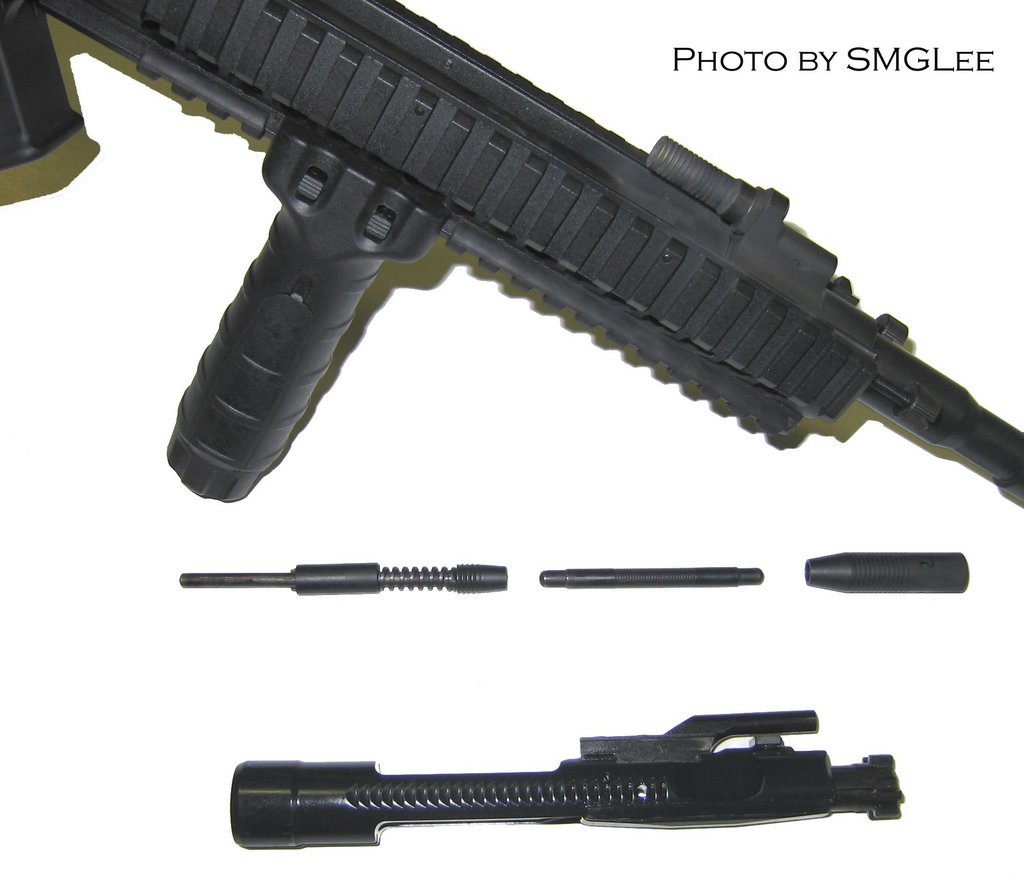

    The breakdown view of the gas piston assembly.
    the gas key are modified direct gas key with a embedded stake inside to keep it from breaking apart from the punishing piston strikes.
    the long rod are inside a protective tubing which has some vent holes underneath to help clear any dirt or grind.

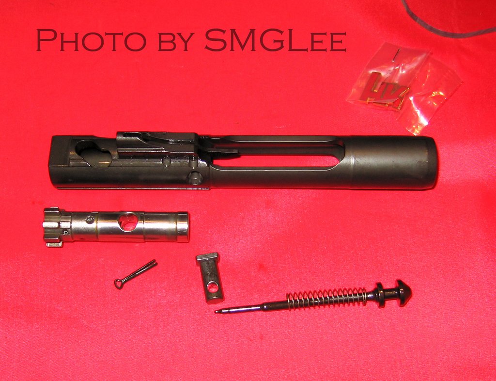

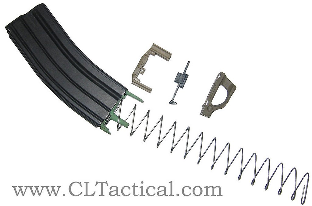

    Simpliest and the most effective upgrade to any AR platform.
    Extractor spring upgrade...I just happen to have a Bravo Company kit that consist of a upgraded spring, rubber o-ring that is made with a more durable material that will withstand the heat from the super heated gas, lube and solvent.
    Many company offer this upgrade, Bravo, CMMG, Specialized Armament. I have been using the Speicalized Armament upgrade spring with a LMT o-ring in all my bolts.
    one other ovber look items, and some said is a overkill is the magazine follower. I always highly recommend the excellent MagPul anti-tilt follower. I make sure all my mags are equipped with this prosduct.
    The standard green follower is on the spring compare to the Magpul.
