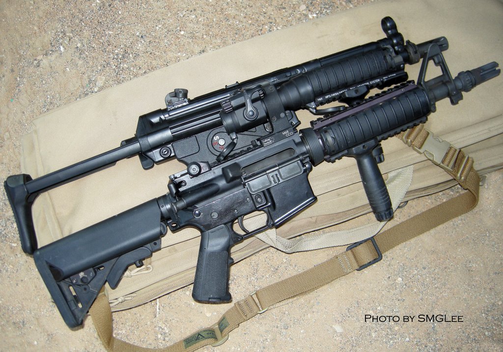

    Here is some pictures of my new toy...
    HK 416 14.5inch upper with AAC blackout flash hider and PRI military latch on charging handle
    EOTech 555
    Tangodown VFG with a unknown side sling mount i found in the parts bin.
    Vltor offsit flash light mount in up right position. I ride my hand high on the VFG so it is very natural for my thumb to rest on the push button.
    Surefire 6PLED with Tactical NightVision Company 256Lumen LED lamp conversion.

    This is why MP5 is being replaced by the USSOCOM and LE agency across the country...same size, better against body armor, longer range, and no over penetration.

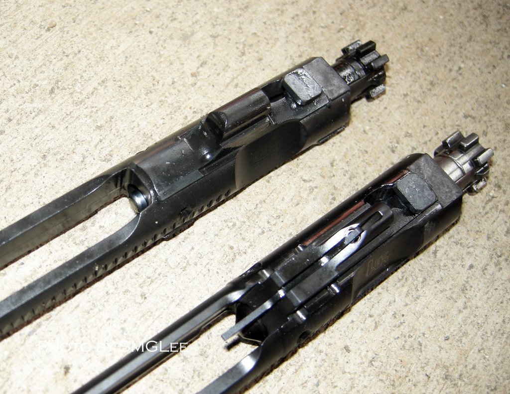

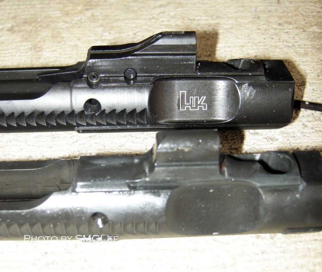

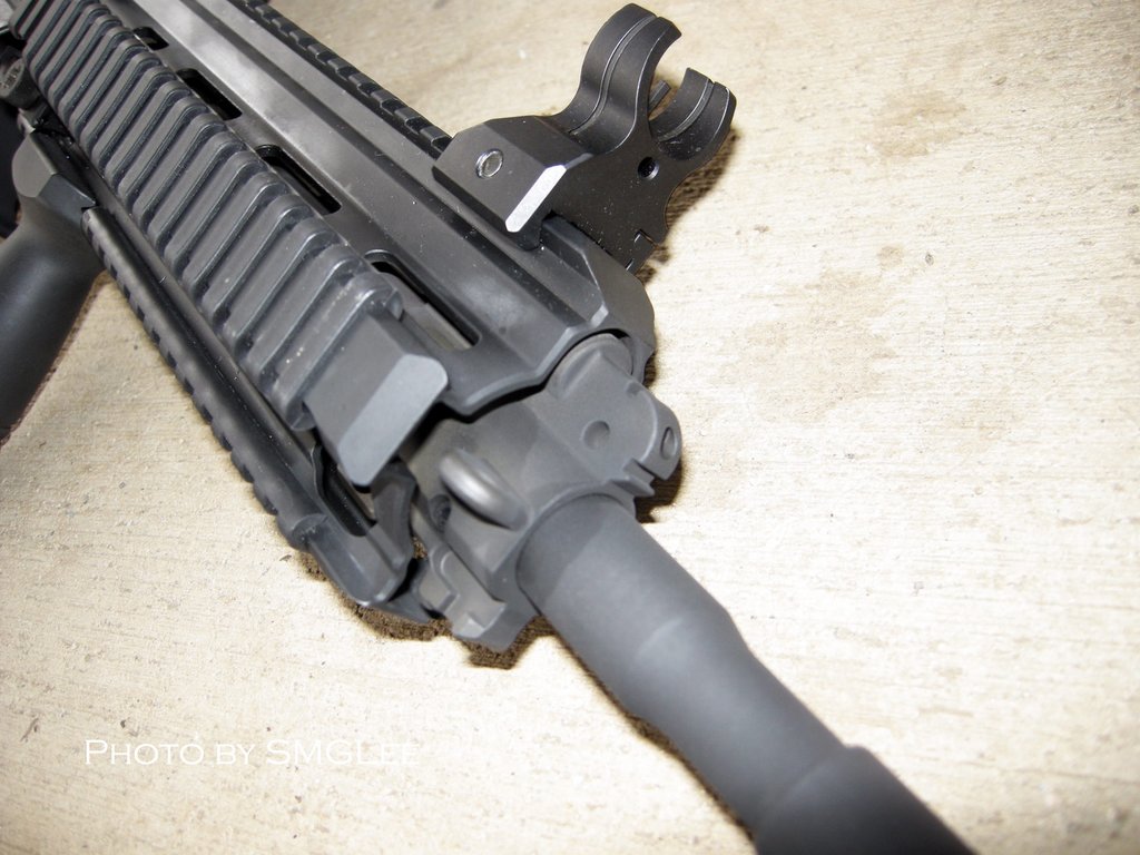

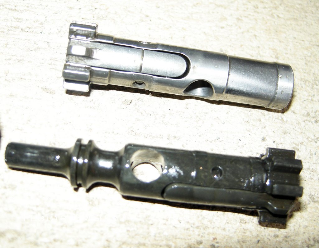

    HK 416 utilize a lot of proprietary components, from barrel, barrel nut, bolt, bolt carrier, to firing pin, none of this is interchangeable with the Direct gas guns, and you would have to run the HK buffer and spring in order to keep the recoil impulse in check. But with the MRP you actually have a few more common parts to the DI gas gun than the HK, you can still run the standard bolt and firing pins inside the MRP which are some of the more commonly replaced parts in the AR system. With the HK, you would pay a high price for the armor’s tool just to remove the barrel, with the LMT, two torque screws which keep the barrel secured in the monolithic rail platform. For those of us that are not on a government budget, the MRP is definitely a lot easier to service than the HK 416.

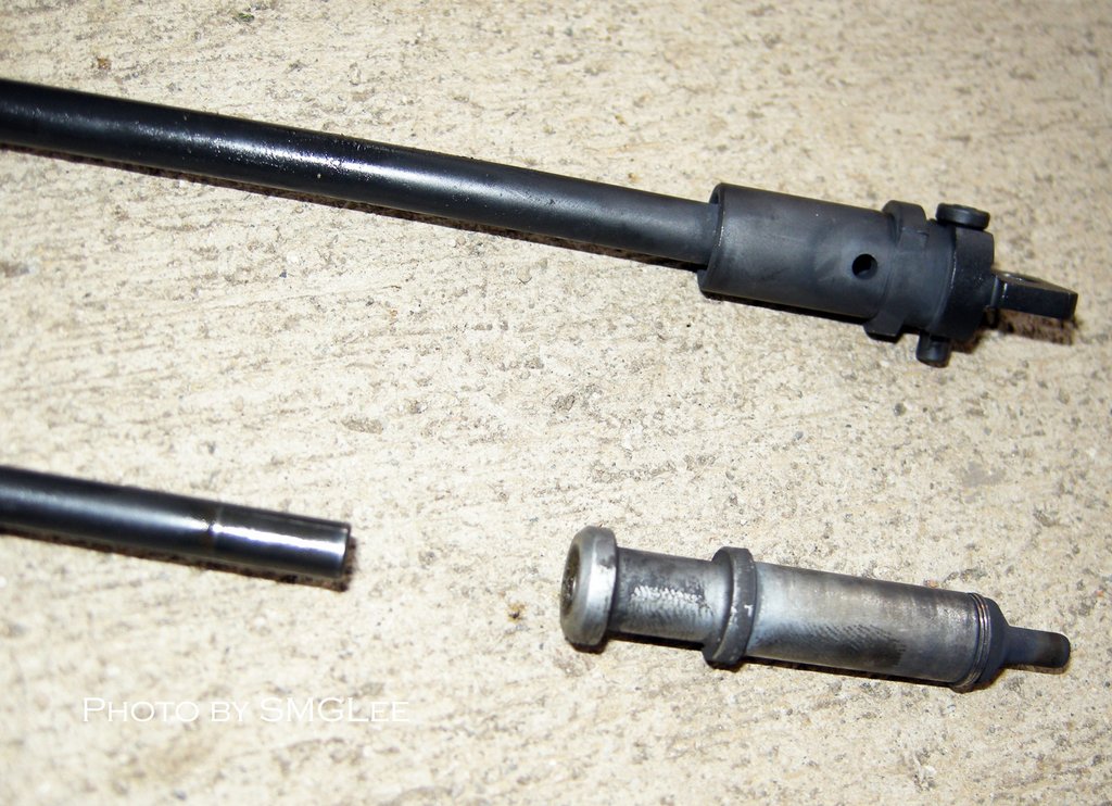

    HK piston is a top loading system, although the rail system on the HK 416 is supposed to return to zero, a lot of operators I spoke with never like to remove the rail to clean the piston since re-zeroing the PEQ15 are very time consuming task. LMT MRP is a front loading system; all parts are easily accessed by removing the front gas regulator plug, so you do not have to remove the rail system to access the piston. Also the plus is adjustable for standard fire and suppressed fire; this is a major plus for those that run suppressed guns. We had the opportunity to shoot both system with the excellent AAC M4-2000 and the result was interesting. With a suppressed piston system, it is naturally much louder than a suppressed DI gas gun due to the gas regulator releasing excess gas. The LMT MRP shot slightly quieter than the HK 416. We measured with a studio quality sound meter placed at the shooter’s left ear. The HK piston system shot approximately 1.5dB higher than a DI gas gun, but with the LMT the sound suppression came within 1 dB of the DI gas gun. Both guns ran higher cyclic rate when suppressed, but it was still slower than a Colt M4 suppressed.
